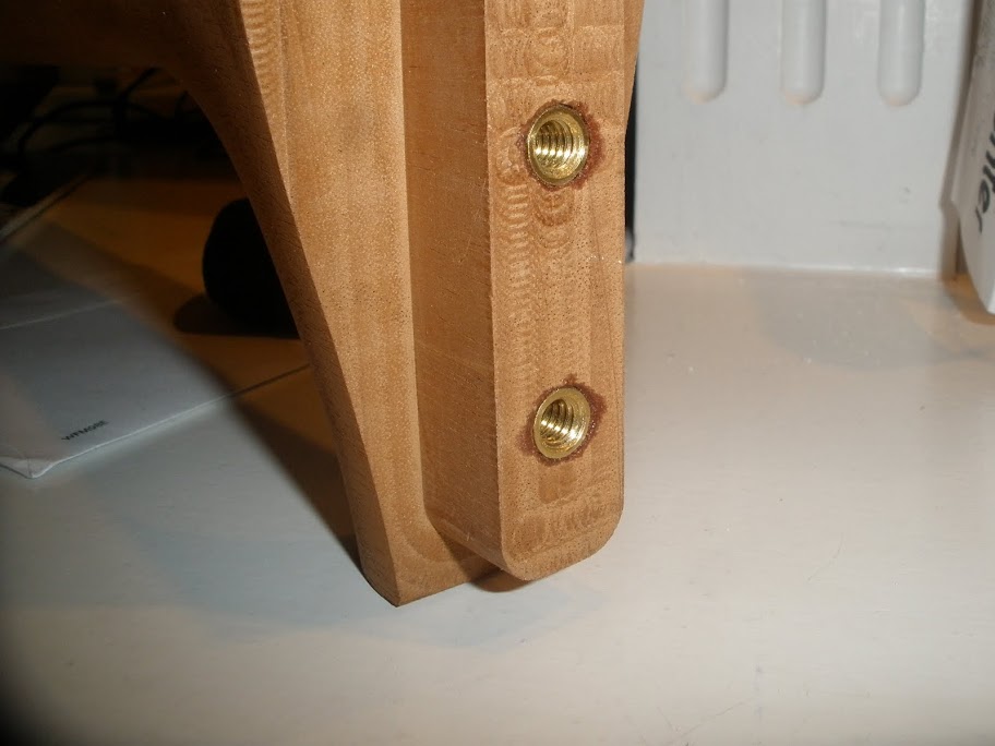

Good info guys, thanks for the help. Below is a pic of the neck and the threaded inserts. I bought the neck a couple years ago before I ever made a bolt-on neck so just assumed the hardware on mine was standard. I know better now. Anyhow, as you can see, the threads are not really adjustable and any trimming I do to the cheeks will affect the angle of the bolts. Since I dont have to adjust very much, I'm thinking slightly larger bolt holes will allow for proper fitting of the hardware. Any other thoughts?
PostPosted: Sat Jan 15, 2011 7:16 pm
That is the way to do it. The tenon should NOT hit the mortice. I make my holes for the bolts in the neck block large enough so the angle is trivial.
Typically I use barrel nuts instead of threaded inserts in the neck tenon so they can rotated to account for the angle difference.

John: Lots of folks use inserts and hanger bolts also without any trouble. The slight angle differance will most likely not be a problem and if it is you have answered your own question with the larger holes. I use the barrel bolts but would not be one bit afraid of doing it with the inserts.One thing I do is not try to fit the whole cheek. I undercut the cheek all but about 1/8" on the outer edge,then fit with the so called flossing. Good luck and take care.

I second what westca said. Drill the bolt holes in the body neck block slightly
oversize. A slight change in the angle of the neck will not cause a problem. The
main structural/acoustic connection between the neck and the body is the contact
area of the heel. I also undercut the heel cheeks like westca, to simplify the fitting,
and make it easier to get a really snug fit along the areas that do contact the
body.
