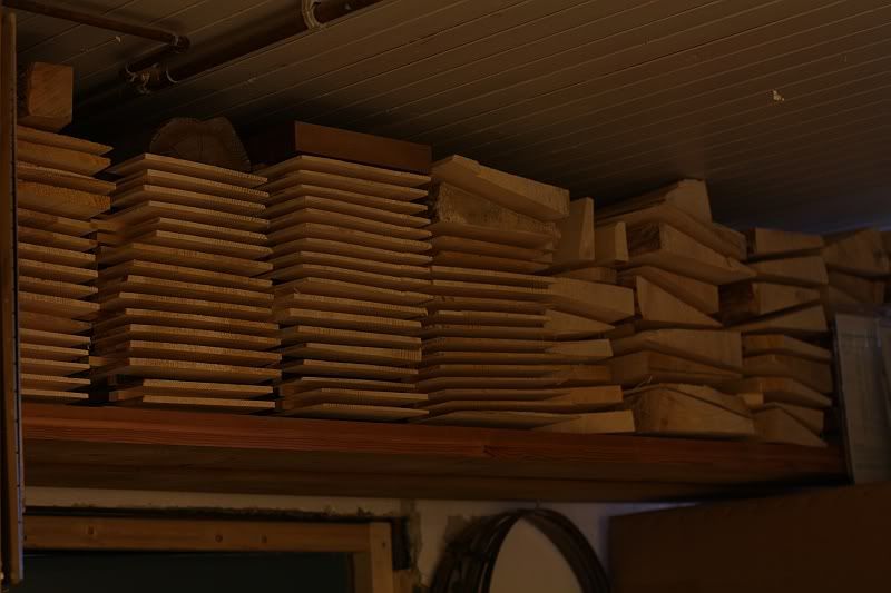

PostPosted: Sun May 01, 2011 3:42 pm
I try to store wood and parts according to where they are in the building process.
Here's the lumber rack for large boards, which is made of ¾” steel pipe, protruding from 2x4” uprights screwed to the wall. The rack is quite strong, and allows me to store up to 4 metre (13’) pieces, which is about the length of these mahogany boards when I buy them, so I can keep them intact until I know how I will use them.
This is the “dusty” machine room, with is a non humidity controlled part of the shop.
This room is also where I store recently processed wood, such as this stash of local spruce, on an overhead shelf.
