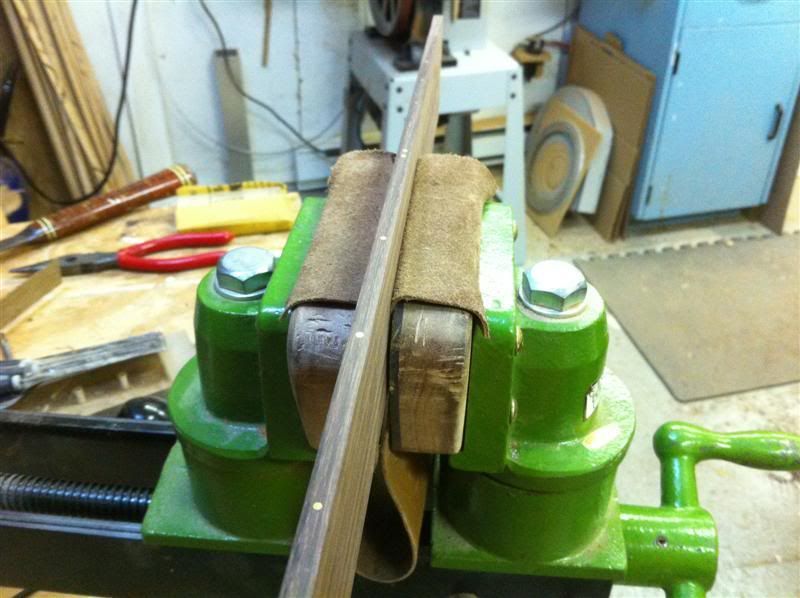

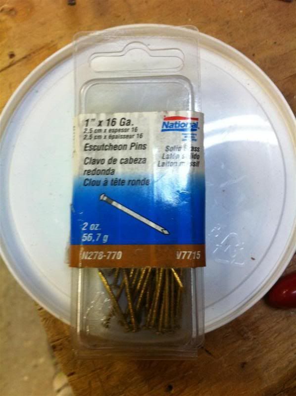

PostPosted: Thu Sep 08, 2011 12:50 am
I just used 16 ga (1/16" dia) brass finishing nails today for side dots. Worked perfect. 3 nails does all the side dots with double at the 12th fret.
