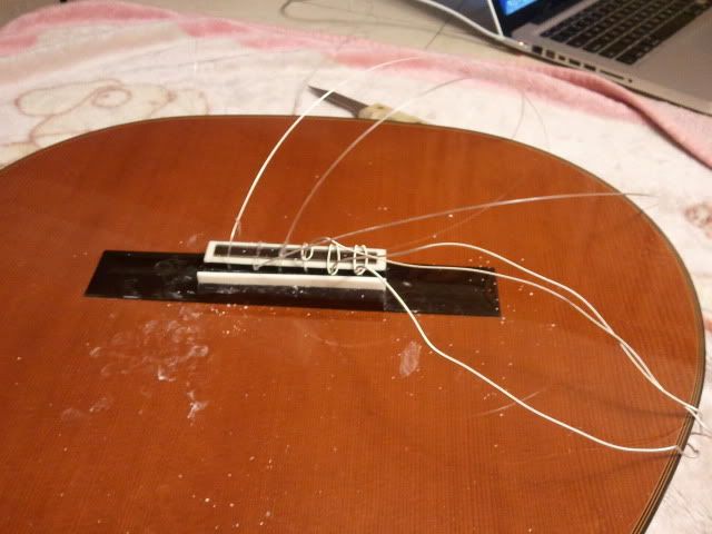

Here's the old saddle - you can see how low it is, especially on the treble side...

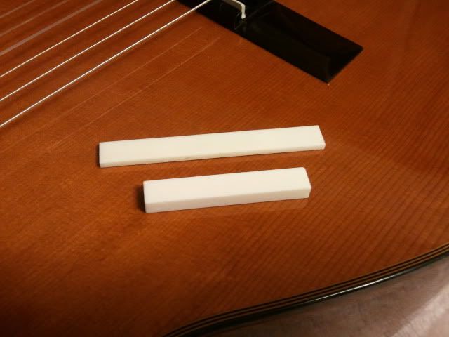

Here are the new blanks...

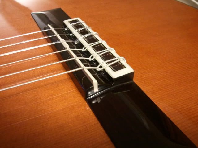

After some filing...

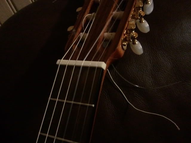

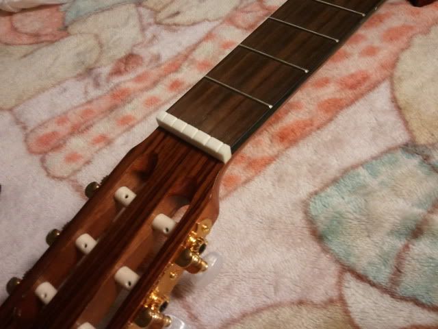

The new nut...
With the strings on... a couple of the slots have to be made a bit deeper.

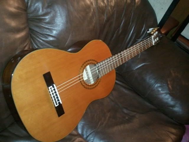

Here she is...
