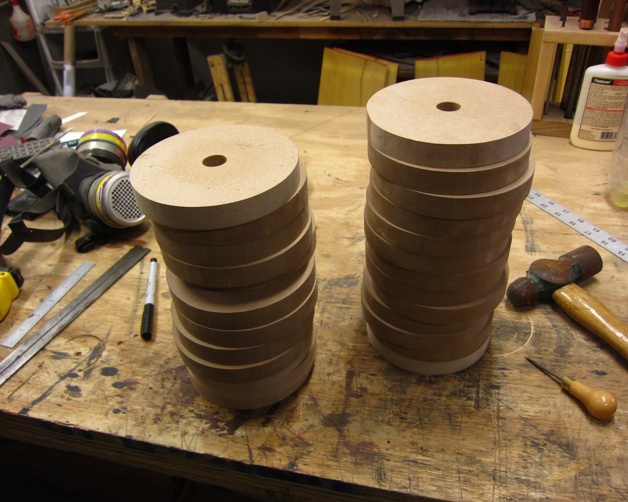

Steve Davis wrote:
Whats the best way to make those MDF discs?
I don't know what the best way is, but what I did was use template (actually the 5" pulley) to draw the circles on the MDF, then cut them out close to the line with the bandsaw, then sanded to the line with my belt sander. Then I used a compass to find the center, drilled a pilot hole, then used an awl through the pilot hole to mark the others. Then I used a 3/4" forstner bit to drill the shaft hole.
It got pretty tedious, and I ground off part of my left thumbnail at one point, but it took less than 2 hours, and looks pretty good:
http://www.pattonblades.com/4511-10.jpg

The discs don't have to be exact as they clean up very nicely when you true the drum with the sanding block. I just laid mine out and bandsawed. Looks a bit rough when you glue up but cleans up quite easy. I did not leave gaps between discs and used titebond glue,disc locked at one end of shaft as explained in earlier post. Also I did not use velcro but rather just wraped the sandpaper on the bare drum.
