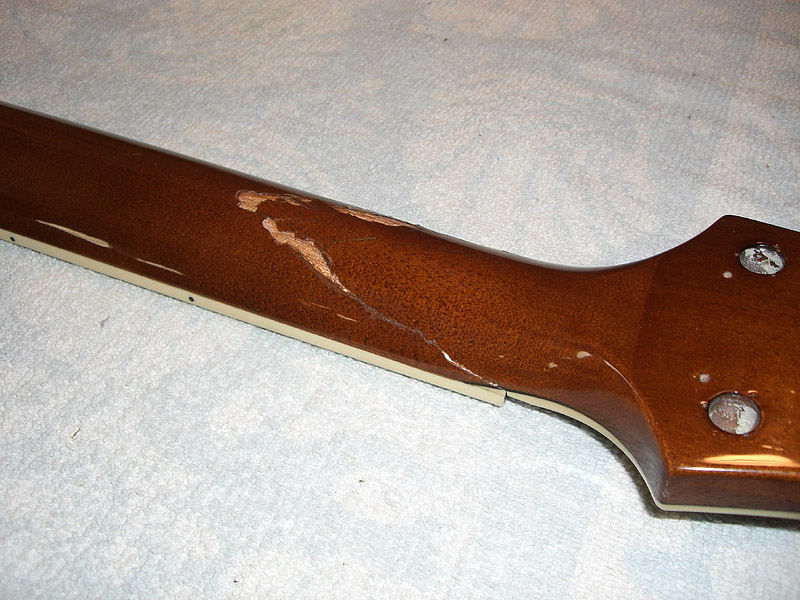

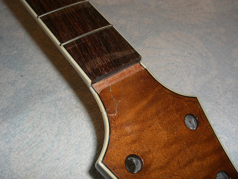

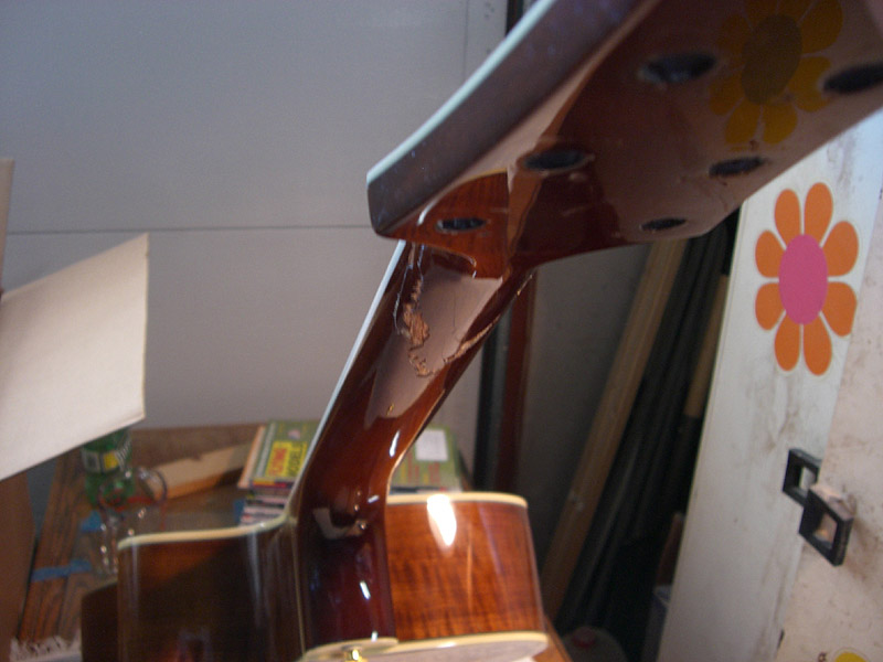

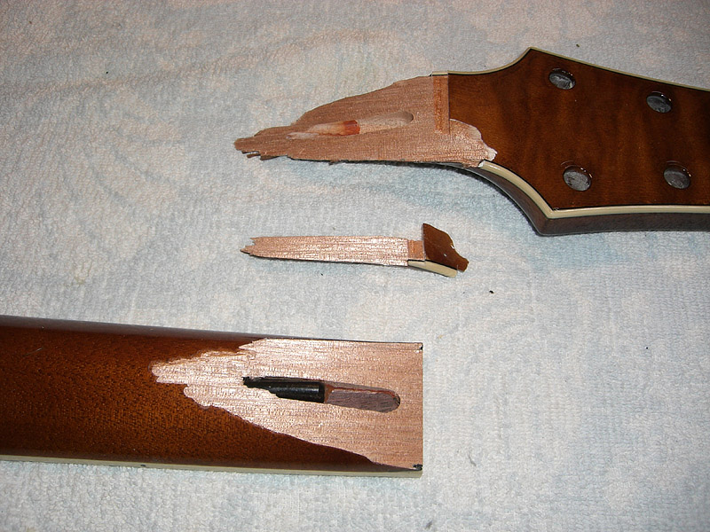

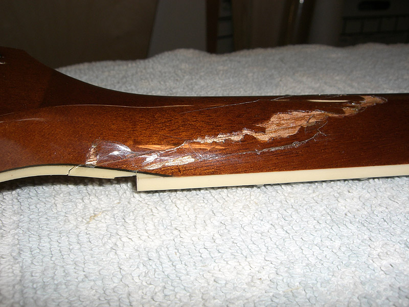

First, the break, and it's an ugly one. I don't think a couple thin coats of lacquer will hide this one. ;)

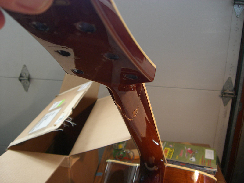

And the repaired neck. First, the good side.
The ugly side. Lots of thick, catalyzed finish missing here. I'll probably use some sort of tinted, thickened epoxy to fill the gaping crevasses. The underlying wood is mostly there and level with each other, which is good.
The top side. The cracks in the veneer are mostly filled and level. Some light sanding/polishing should make this mostly invisible.
