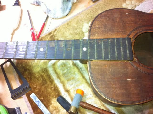

First order of business is to de-fret the thing... the fingerboard is going to be replaced, and whatever this wood is, it does NOT like having its fret removed.
