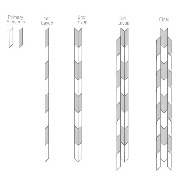

PostPosted: Thu Aug 16, 2012 3:49 am
Lar, it looks like one element shape, in a two color layup, repeated 4 times.
I've laid out the process as I see it.

That looks like the easiest way to lay it up. To have it recognizable as houndstooth, it would need to be layered in multiples of four. 12-16 layers would look great.

Billy T - you always amaze me! I'm not even going to ask how you modeled that so quickly!
John - What an "Au-ful" possibility! :D
Stephen - don't get me started!
PostPosted: Thu Aug 16, 2012 11:55 am
L. Presnall wrote:
...Billy T - you always amaze me!
Well... People usually say I scare the heck out of them ...I guess that's close! laughing6-hehe
L. Presnall wrote:
I'm not even going to ask how you modeled that so quickly!...
Cause I did it WRONG!! laughing6-hehe

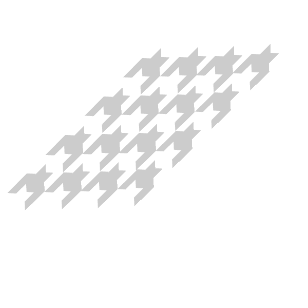

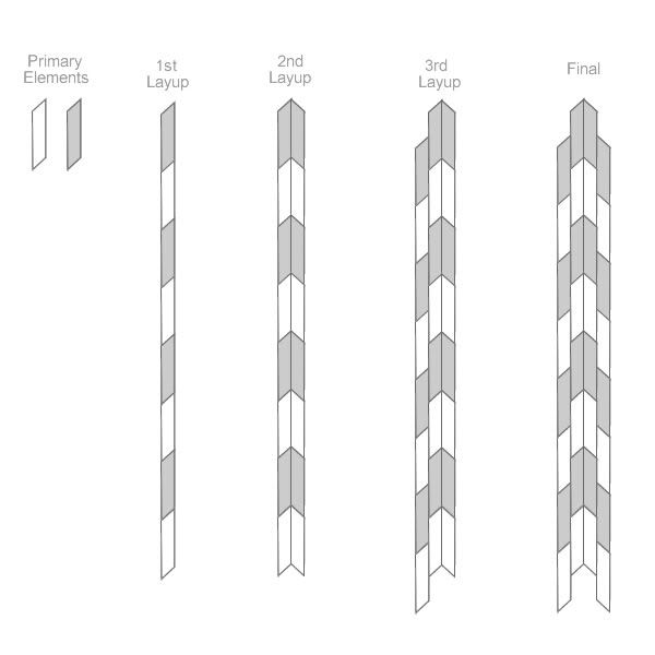

I inadvertently inverted the two center layups! Here's what it should look like!
And here's what they would look like laid together in a full houndstooth. Just in case, I don't know what exactly you're doing.
Here's a picture of where houndsteeth come from!

Looking at Billy T's final pic, what if you just split a piece of Herringbone down the middle than glued the side pieced to another strip (but backwards)? If you are doing black and white, I would think that would work.
PostPosted: Sun Aug 19, 2012 11:29 am
Best bet Lar, is to do a straight layup of flat veneer, fishpaper or plastic and after it sets cut the small strips on the bias. I'm pretty sure the angle is 45º.
I don't know how wide you're planning on making these. That would probably determine what's the best way to approach this as for material and technique.
PostPosted: Sun Aug 19, 2012 11:58 am
Billy, I'm a product of the Alabama Public Education System. 'Laborate a little...I think I'm getting it, but I need another illystrashun...
