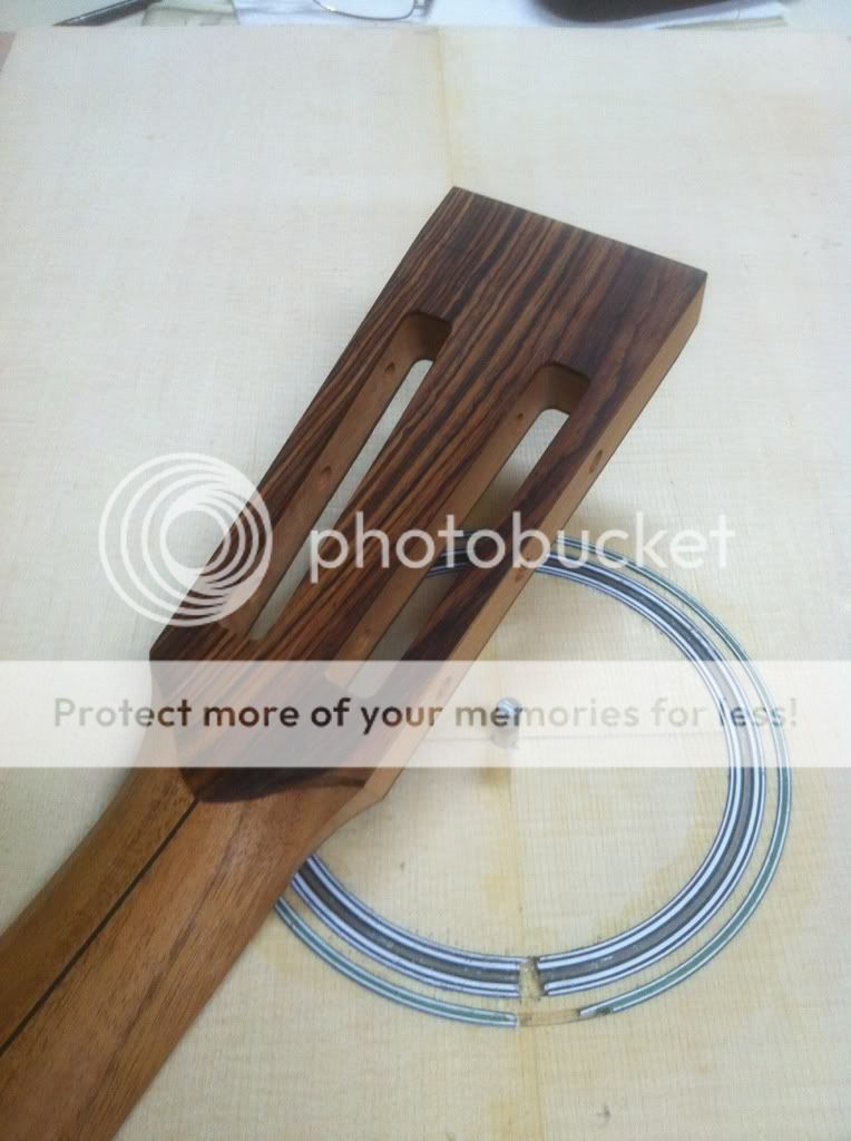

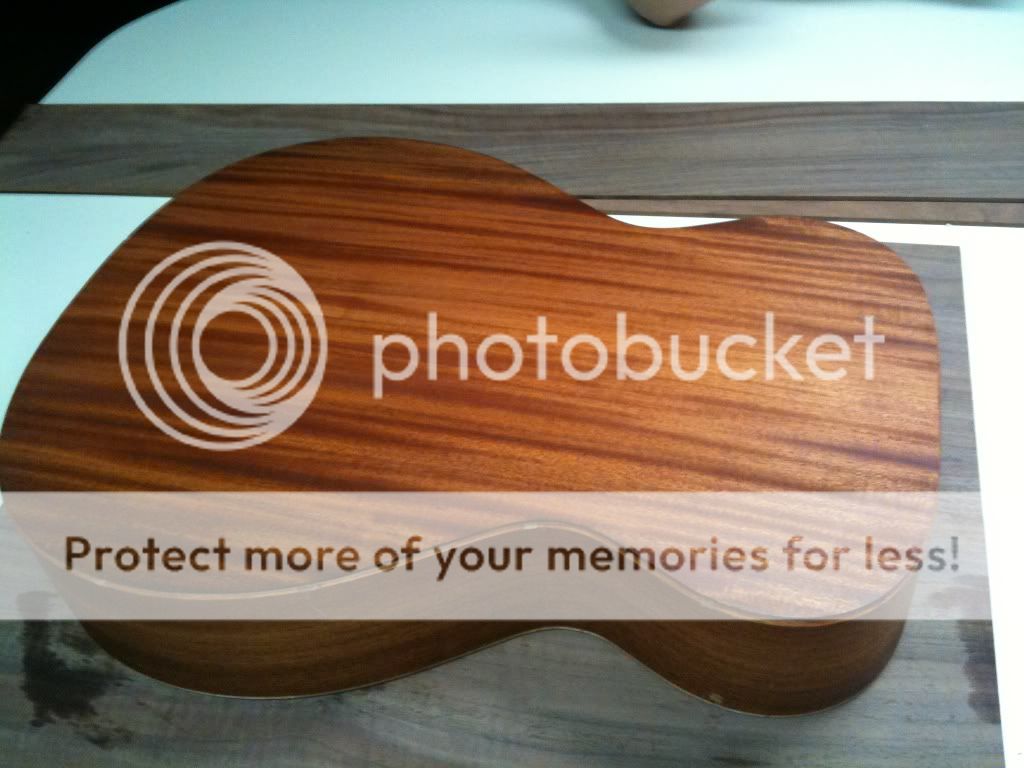

I purchased some dyed black wood purfling from StewMac and I think I'll use it on this guitar. The black lines in the Cocobolo were mentioned. This Cocobolo does have some black lines in it. It looks nice when I hold the binding/black purfling up against the body so I'm happy to get this feedback. Now my only concern is how thick to make the black line <smile>.
Here is a shot of the coco binding, the Cuban mahogany body it will go on, and the single black line along the back of the neck:

Nice bindings! Wow! Talk about flavor......
Pat
