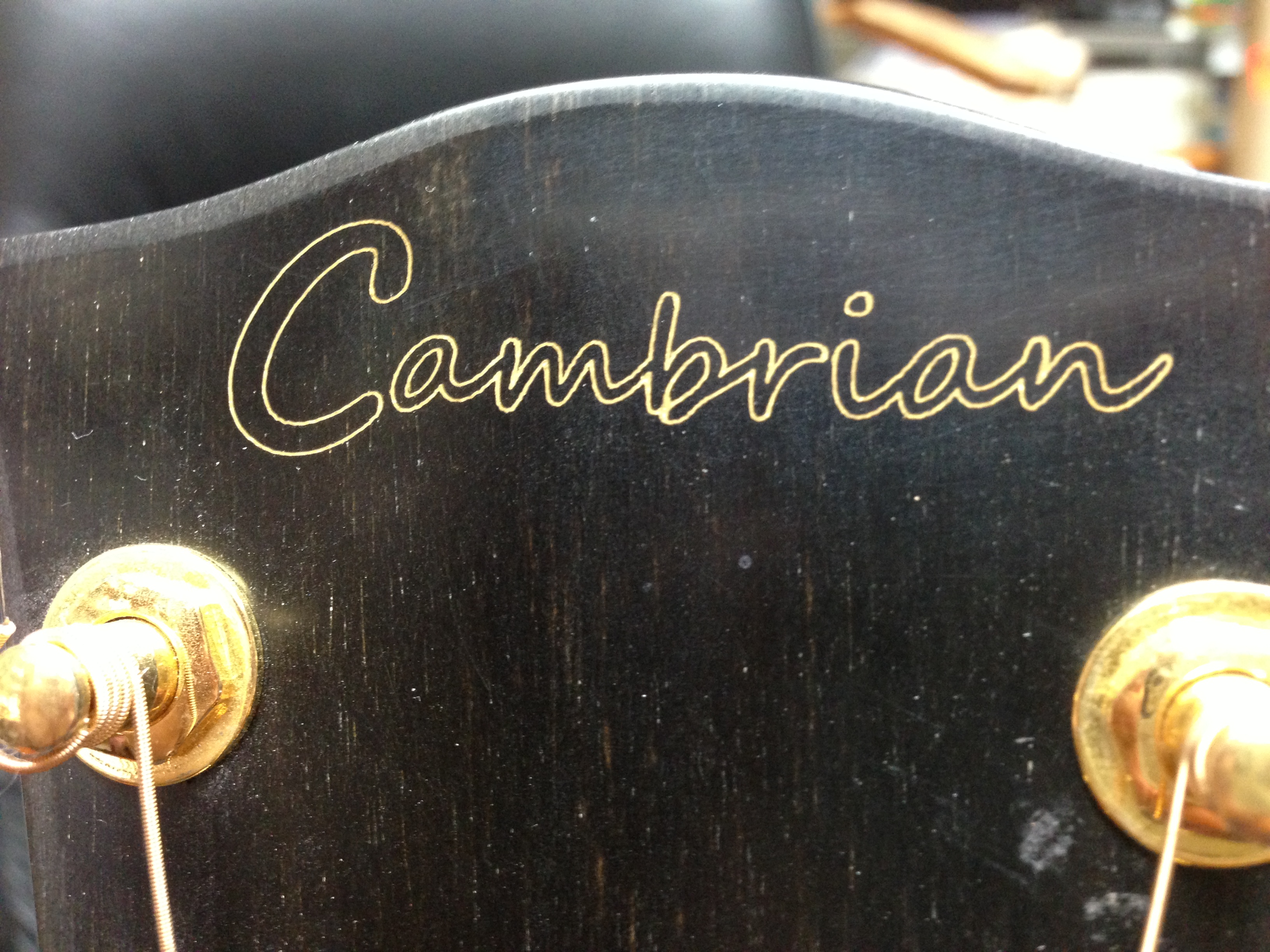

I cut fine grooves in my headplates using a laser engraver, then over-fill them with metallic gold acrylic paint (available from any good art supply store). Once dry, I carefully sand the over-fill back level with the headplate and voila, done. Looks just like inlaid fine gold strips - works particularly well on ebony:
Click on the picture to see it in hi-res. Hope this helps.

So far I've tried the fine bronze powder and the Pearl Ex pigments in epoxy, polyester (I'd forgotten how I hated the smell...), CA, and even straight into melted shellac with a variety of techniques. Generally the overfilled cavity looks great - nice and shiny, but dulls pathologically on levelling, not to be revived by any form of buffing or over coating. This seems to correspond with the reports of other users in various woodworking blogs/forums, yet there are occasional pics from people who have made it work by seemingly doing nothing different from what I've tried. Success may be very dependant on the various brands of the stuff used. All I can tell so far is that none of the "generic" combinations I've used have worked for me.
Next up may be some coarse ground brass (just filings) which on the trials I've done so far provide some glitter, in a "yellow" ground to give the right basic colour. Or maybe some of the fine bronze powder in PVA glue... (which may be a close approximation to the acrylic paint you're using).
