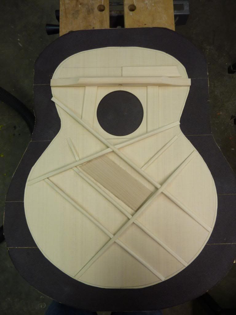

Tony, here is a picture of the bracing:
and on an angle:
I wanted to err on the side of being over braced so as you can see, I put in another fairly big brace that crossed over the bass leg of the X brace and the tone bars. Also, in drawing up the plans I approximately centered the saddle between the braces. I think it might have been better to focus on centering the bridge pins between the braces. With the bridge being on such an angle, the shift between the saddle and the bridge pins means that had I centered on the bridge pins, I could have come down more with both the treble side leg of the main X brace and the extra brace that crosses the tone bars. I'm not sure if it would have made and difference in the end, but it would have put the X brace a little closer to its conventional position. I didn't realize this possibility until I drilled the holes for the bridge pins and saw that they weren't centered on the bridge plate (duh!).
Pat
