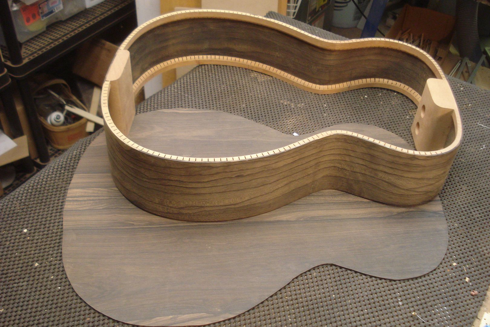

The tops and backs are braced for both guitars and the 00 is voiced and ready for closing the box
Here are photos of the 00 12fret progress
Fred
Fred Tellier

Hi, Fred. I noticed that your cutaway neck block has some extra-stout top reinforcement surface that the other one doesn't have. I'm sure there's a reason why you've built them differently, and I'm curious. Seems like the cutaway would already have a bit more longitudinal strength due to the presence of the cutaway side running almost parallel to the neck. But I'm probably missing something. Would you explain?
Great looking sets, man! I'll be watching!
Patrick
That one will be a complete removable bolt on neck and the other will be a glued down fingerboard style bolt on. I have always only did dovetail joints, so these are to evaluate the 2 styles of bolt on neck joints.
Fred

Yep, I missed something, and now that you explain it to me, it seems pretty obvious. A bolt on neck and bolt down fingerboard extension. Makes perfect sense to me now. Thanks, Fred. Press on, man! I'll be eager to see them.

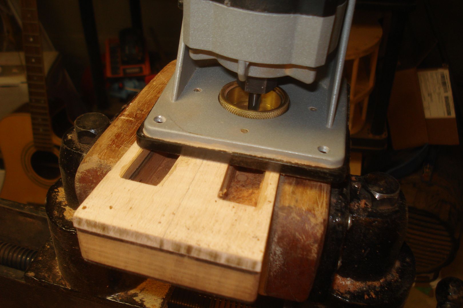

The neck is ready for the 00 here are some pictures.
My routing pattern for the slots and the StewMac drill jig I picked up used and the finished peghead.
Fred
