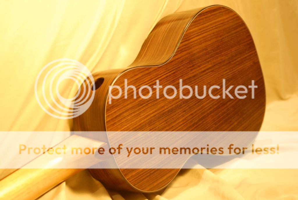

Well I'll be going off to college in about 7 months and after going on a few campus tours of some of the schools I've applied to, I learned one very important thing; dorm rooms are small. I had always heard that dorms were small, but seeing it in person really made me realize the difficulty I might have storing a standard guitar when I'm at school.
Luckily, I've been working on a design for a parlor guitar for a while and just finished up the prototype. I'm very happy with this prototype and plan on building more of these, including one to bring with me to college (that one will be made entirely of tone woods from the east coast of the US; if I study abroad, travel with it will be very easy).
Anyway, the specs of this prototype are:
Adirondack spruce top/top bracing
EIRW back, sides, binding, backplate, and heel cap
Spanish Cedar neck, kerfing, back bracing, and blocks
Madagascar rosewood fretboard, bridge, and head plate
Grover Sta-tite tuners
French polish finished rubbed out with rotten stone
2 way StewMac truss rod
In total there's about $100 worth of material in this guitar

That looks really spiffy! I like it a lot!

Looks great Brian. Nice to see you are still at it. Good luck at school.

I really like the small guitars and yours looks especially nice.
Curious about the top as well. II've used spruce and port Orford cedar but never Adirondack. Love the sound hole treatment. Keep up the good work.

That is a sweet looking little parlor or travel... or traveling parlor... What ever it is it is way cool... I am sure you will get a lot of enjoyment out of it while you are away at college.

Pretty little guitar. What are the dimensions and scale length?

Curious too. And BTW I did notice that the sound is not oval ovalsoundhole.

Very nice, Brian, I like the low key rosette you did. Anything bigger would be overpowering. Does the smell from the P.O. cedar top fade at all? I've got a couple P.O. tops, and they make my eyes water like Vick's Vapo-Rub!

For some reason I cant see any pics :( All I see Is:

Nice looking little guy. I like how you did the rosette

Love it! (my headstock design is virtually identical to that so of course I REALLY like that part :) What are you going to study at school if you don't mind my asking?

Very Nice!! I like these small size guitars. I'd also be interested in her dimensions.

Thanks everyone, the overall length is about 35", the scale length is 24.625", the lower bout is 11 1/8", upper bout is 8 1/4", and the body length is 16". The adi top was very stiff, so I brought the top down to just .075". The top lacks any tone bars beneath the X bracing too; this was borrowed from Laurent Brondel's D-5 guitar.
This was just a prototype that I won't be bringing to school; there are things I want to change for the next one.
