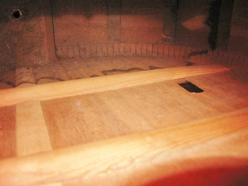

I want to take some photos of the insides of an old guitar. I can't really manipulate mirrors. I was thinking of buying a borescope, but the ones I see listed mention a very close focal distance. Can anyone advise me on techniques to photograph inside the guitar?

Cheap solution: web cam.
Also, some small, pocketable point and shoot cameras work, though they'll likely not have as wide a field of view as needed to capture much area.

Yesterday I was trying to adjust a truss rod with an allen key and could not get it to fit. I stuck my Iphone inside and took a picture of the brass nut. Doh!
Picture came out pretty good.

There are endoscopes available on ebay around ten bucks, they will work but you need to build a pointable base to get a steady picture and to get your bearings inside the instrument. They use USB feed to your computer.

Ryobi Phone Works scope. Attaches to your smart phone $100. @ HD.
Pat
+1 I use a webcam and lap top. I can snap the pics I want right on my computer. Works great. Here's a pic I took of a customer's D-18 showing loose brace and water stains near the tail block:
