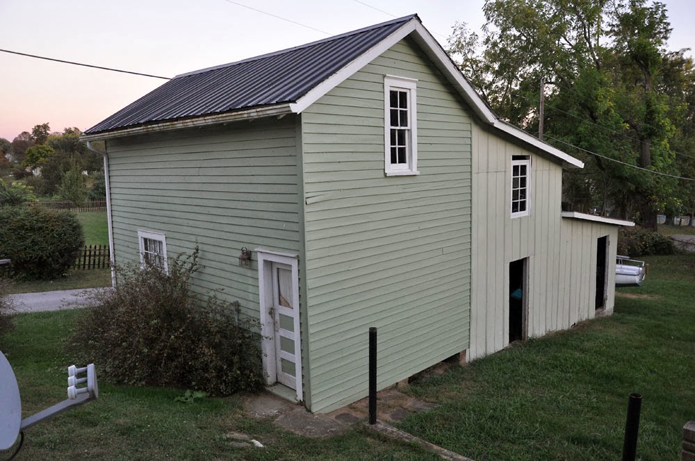

So it's been a year since I moved to a new house and I've yet to build any guitars. I've got my repair space set up in a controlled basement so that's been keeping me good and busy but I'm getting anxious to start building again. The house we bought has two outbuildings, one we refinished to be my wife's pottery studio and the other the guitar shop with some all purpose shop space and a gallery for our crafts.
It's incredible how long this takes but we are almost there. So I've been researching the heck out of heating and cooling and have concluded that Mini Splits would be a great investment. The shop space is two floors. It's an old barn that is roughly 11X22ft with a loft that is about 11x18ft. The floor is hardwood and I had 2in of closed cell foam sprayed under that. The ceiling is vaulted and was filled with 6in spray foam. The walls are all pink batting insulation.
I went to a local HVAC place and was quoted over $5k to install mini splits... Way way over budget so in doing research I found that there are these do it your self systems that come precharged and look like a snap to install. HEre are the two that are high on my list:

Anyway here is where I am, before after. This weekend will finish a lot of things I hope.
The shop building:
The first floor when we moved in
First floor today
