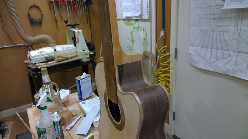

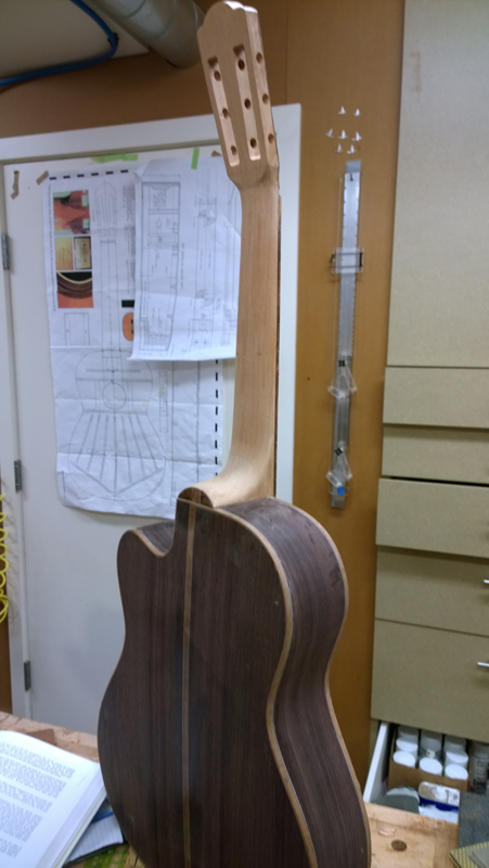

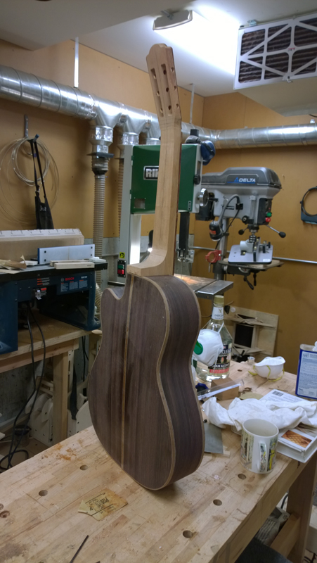

I made a bunch of progress on this guitar. I did radius the top rims, but flattened out the upper bout a bit.
The top as a 32' radius, the back has a 10' radius. Although the guitar looks more contemporary all of the final set up will be within the classical guitar range. I put a 20" radius on the fret board.
It is starting to look like a guitar, maybe even a bit more like a classical guitar. I still need to finish carving the neck. Although it is a more contemporary design it still is a classical guitar size and the set up will be within the classical guitar range, for neck thickness, nut width, string spacing and what not.
I am thinking a bit about the final details like adding the closing binding between the neck and the rim and the cutaway. It would provide a clean finish, but it is a bit of a busier look than I really want.
All and all it is starting to look like a guitar.

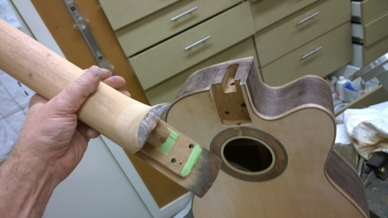

I did a bunch of prep work and cut ramps in the head stock slots. I made squared off ones for the first time. A little scary I just cut the edges with a razor saw and carved out the waste with a chisel. There is a bit of back and forth to get the line between the veneer and mahogany to look symmetrical.

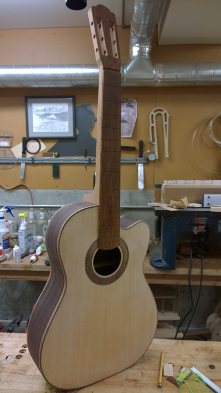

I am getting really close on this one. I just glued on the bridge and I thought I would try a tap test. I think it came out with working values. Depending what happens with the strings, I can add mass to the sides if I want to lower the top off F# (I know it is right on F# as I have my falcate SS guitar on the wall with the g string tuned down to F# and it started singing. I left the bottom back brace pretty tall so I can get the back on target as well. I will wait for the strings first. From a closed box tap test the top came down two hertz with the bridge and air up about 2 Hz. My fret board covers a bit of the sound hole so that might be what changed the air resonance.
On to the fretting the guitar and finishing the compensated nut
