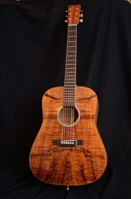

Here's recent photos of one of my David Russel Young models I built 40 years ago -- Deft Semi-gloss -- I respect your guys opinions but I have used many gallons of Deft and had virtually no problems and never a problem with it not drying -- no, I take that back I applied it over an oil stain that was not completely dry and did have to strip it.

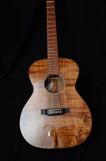

Here's two of Tony Costas' I believe are brushed on Deft Gloss -- not too shabby!
Have any idea how much the formula in that can has changed in 40 years?? It ain't the same product in there anymore! The resin formulas have been changed to work with different solvents. EPA regs have mandated that....... Even my professional formulas that are not available to the general public have changed just in the pat two years....... I have used many many gallons of finish over the last 40 years myself from all the major brands and stand by my statements on Deft brand lacquers.
