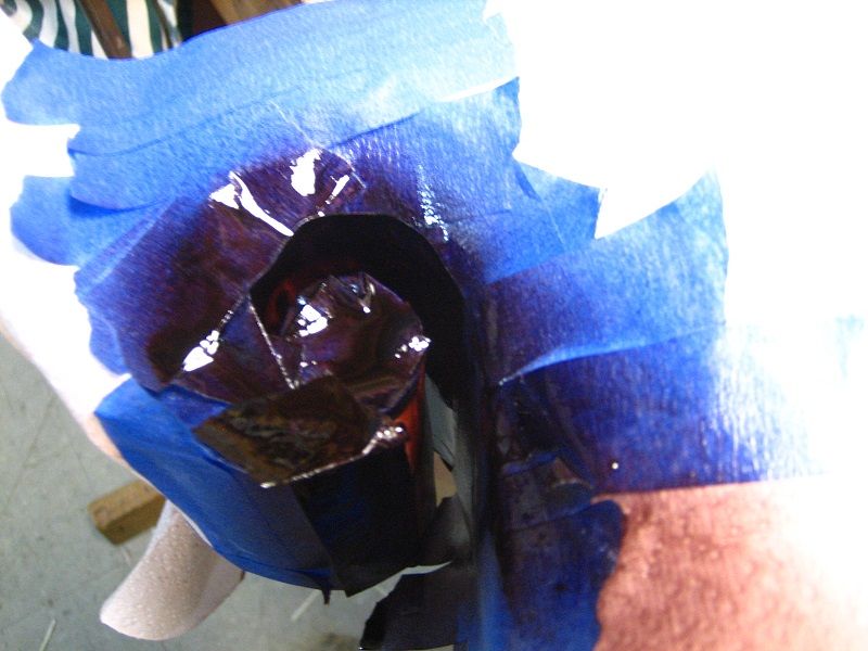

I have the same equipment as you but this natural maple guitar needs color sprayed on and a sunburst to the top. I am using the preval unit to custom mix and spray this small amount of color. After sun-bursting the top (and before I remove the tape covering he binding) I will switch to my Fuji to lacquer over and seal the color. Then remove the tape, scrap the binding as necessary and add enough clear lacquer to be able to level (again using my Fuji). This is why I chose the preval unit. Test it first to see if it will for your application.
Getting spray inside the scroll worked best with this unit. Heavy cleanup after but worked.
Tomorrow I do the top.
