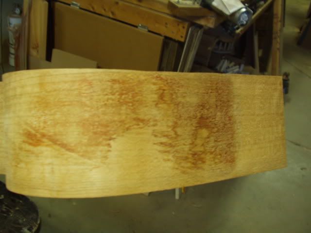

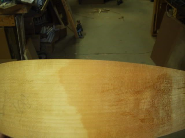

Quote:
I don't use foil and went away from kraft paper to untreated white. Kraft paper ( the brown stuff ) can be acidic and make some water stains.
Me neither I only use parchment paper -- I discovered the problem with brown Kraft paper many years ago. The set in the photos below was stained all the way through, even acid would not remove the discoloration.
Ken Cierp
These users thanked the author kencierp for the post (total 2): TimAllen (Sun Feb 21, 2016 1:02 pm) • bcombs510 (Sat Feb 20, 2016 2:31 pm)
