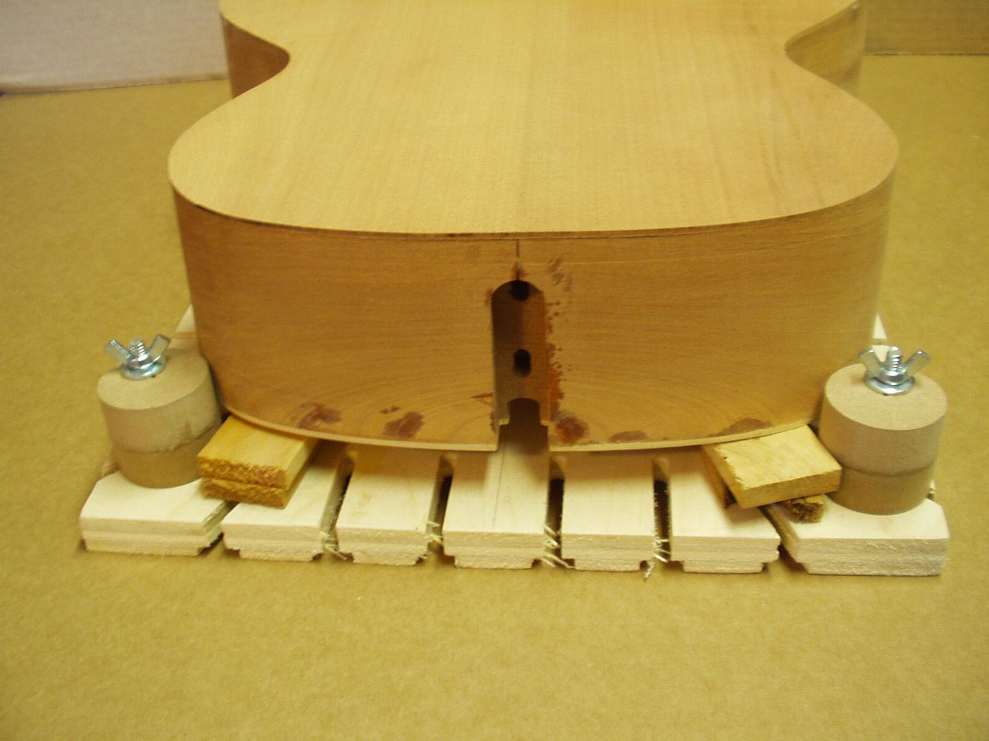

PostPosted: Fri Sep 30, 2016 1:35 pm
My binding set up use to be this
However I'm moved to the Larrivee style from CLS. So I lost the cradle when I sold my binding jig set up.
I always used the cradle when I was installing the binding but found it a bit difficult to get from one side over to the other, thus the idea to make a basic cradle on a stick :D
Ken, I always like seeing your simple solutions to things......keep it up.
