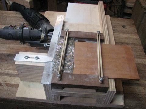

THis is the jig I use to cut abalam strips. 15 dollar dremel blade . adjustable for width of strips. cuts easy and fast.
Clever. Thanks Michael!
