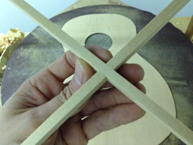

Anybody got any neat tricks for making a great joint where the x brace crosses over.
Mark mine with pencil then carefully cut the notch .Mine are ok but could be better.
There must be a better way
