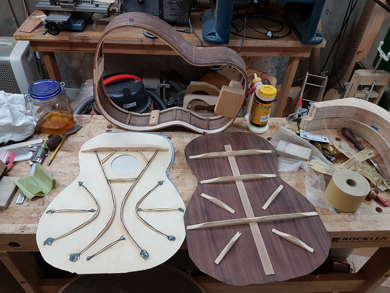

I just finished this falcate classical guitar.
Lutz Top Panama Rosewood B&S ebony bindings. Brazilian Head plate. Ebonised Walnut bridge.
Bolt on-bolt off neck 32' top radius 10' back radius.
Aqua Clear pore fill\shellac sealer and post catalysed Royal-lac finish.
For those into modal tuning ...
I used visual analyzer to take a frequency response curve. I was a bit off of my target frequency's. I was hoping that a top resonance of 190 Hz and the back 4 semitones above that. But I ended up with a top resonance of 186 just above F#. My back resonance was 232 Hz which is 4 semitones above 186. Unfortunately everything is close to being right on a note frequency.
As an experiment I decided to stiffen the back, using a trick Trevor told me, to stiffen the back with the hope that a higher back resonance will move the top resonance a bit more off of F#. I make my braces as shown in the Book with a gabled profile using a router table and a 22.5 degree router bit. I pre profiled the lower bout back brace carving a bit too much out of the center, resulting in a lower frequency for the back than I wanted.
Trevor suggested splitting a section of brace in half and gluing the outside (non cut side of the brace together to make a good fitting cap. Pictures make this easier to see.
The additional height on the brace raised the back frequency up to around 255 Hz with very little coupling to the top which moved toward 190 Hz. I shaved almost all of the height off of the cap with a small plane, mostly counting on what amounted to sister beams on both sides of the original carved out brace.
In any case after a lot of carving I ended up with a top between 188 and 190 Hz (depending how I hold the guitar while tapping) and 245 Hz for the back. The guitar still sounds good. I never really heard any problem with the original response, but it was fun to play around. Also note the relative back response is a little less than the original FRC.

I like a lot, I made three steel string guitars and four classical guitar. They were all good sounding guitars, about half of them are really good sounding instruments. The classical guitars sound like classical guitars; closer to a fan braced guitar than to a smallman or other thin top lattice braced guitars. Probably as the falcate and fan braced guitars both use the same stiffness and thickness tops.
The steel string guitars for better or for worse have more attributes that are associated with classical guitar than most steel strings. Mainly very even response across all of the strings up and down the neck. There is also a clarity to each note. The singer songwriter with a D28 might not be happy with a falcate as they do not have the same response where the bass and trebles standout and the midrange (where most people sing) drops out. I have always wondered if the Larrivée guitars with the ladder braces under the X would even out the response.
