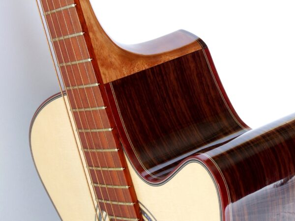

I am building a reproduction of an 1830 Panormo, The model I am doing is one of the top end guitars
Panormo did. It has perfling on the sides where it meets the top and back of the guitar. (see pic)
I am bending my sides on a hot iron and am not sure the best way to do the perfling. I know a lot
of you have benders with heat controllers and glue the perflings to the sides prior to bending.
I am not sure how that would work on an iron with limited temp control.
For reference, I am using a 2 1/2" section of Stainless Steel exhaust pipe with an electric charcole starter
inserted into it. It is connected to a variable speed router controller to roughly control the temp.
Since I have never done side perflings before, is there something I should know prior to trying this?
Any help would be much apreciated
Thanks Bob

I also hand bend on a hot pipe (I use a dimmer to control the temperature). When I first had to bend laminated wood purflings, I asked. Taping them together to make them wider and then bending was suggested. It worked just fine and that’s what I’ve done since when I needed that. For the single strand on the side, all that matters is what shows, so make it arbitrarily thin—you might not even have to heat it. Now, what I usually do with the laminated ones like what’s on you back above, I used fiber purflings which are plenty flexible without heat.
Also, for the purflings on the side, not the back, I cut the channel for them after I glue on the bindings. It’s much easier to push the purfling into the channel than it is to control it while trying to glue down the binding.

I also bend with an iron. I do the same thing Bob does and tape them together.

Thanks for the quick reply guys,
It doesn't really show well but all the perflings on this guitar are W/B/W although it does appear in the pic as a single line (I had to reduce the size of the pic to post it here so it lost that detail).
So if I understand this correctly, you both tape multiple perf's together (unglued) bend them all at one time and then insert them when installing the bindings?
Don't you have an issue with splitting them in the process? Then only time I have done this is with purchased binding with B/W perfling already glued to it and I am sure they were fiber not wood.
FYI, I have already made all the perfling strips using Brazilian Rosewood and Maple.
