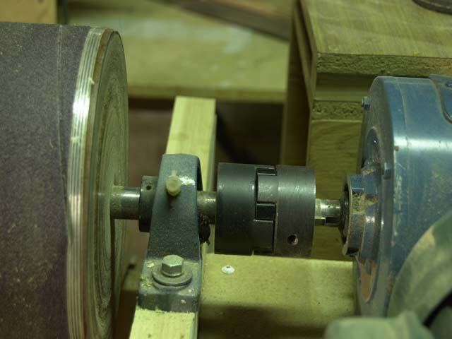

John, I am interested in your direct-drive arrangement. Just curious where you got the coupler. Kicked around for a bit on McMaster-Carr, but didn't see anything like that... could have missed it, though.

If you search on 'Flexible coupling' on McMaster Carr, you should find what you need.
Pg 1115: Flexible Spider Shaft Couplings
You buy a hub sized for each of your shafts, and then the rubber spider that goes between them.
It's probably cheaper than buying two good pulleys and a link belt. It makes the sander wider, but I managed to mount my disc sander and spindle-style sander on the same stand, so it all works out for me.
I just used a grinder and file to make the keyway in the sander shaft- wife wouldn't go for the milling machine for one job!
I got my connector (and the pillow blocks as well) from Princess Auto, here in Canada.
