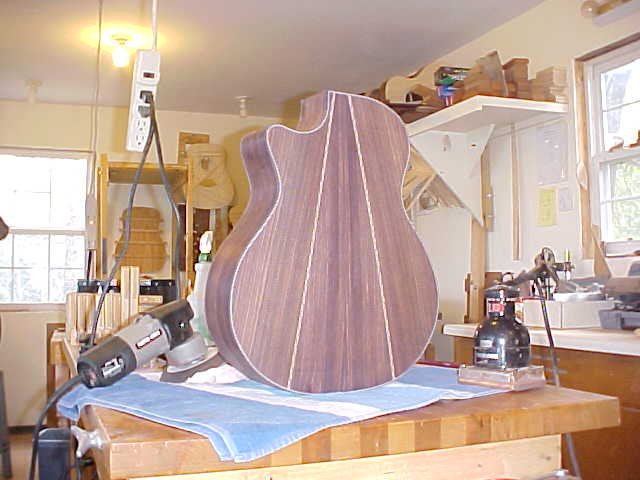

Wow, sometimes it doesn't take a lot to impress me. Today, I got way more than I paid for in this tool. After peeling the tape and scraping laboriously all the duco, tape residue and CA, I grabbed my new 7336 Porter Cable ROS. In ten minutes with a 150 grit disc, it didn't look like the same guitar. Wow. When the guitar goes from ugly duckling to nearly ready for the spray booth that's a great transition.
Then, just for fun, I grabbed my 220 grit laden Porter Cable 330 SpeedBlock sander, oh my goodness, that sucker with the sandpaper curved up into the holder, it sanded the inside curves to "close". A little more work to do there. And Tim, I'm going to have to get out my magnifying glass, but I don't see any little circles buddy.
The speedblock has an OPM of 12,000. I've owned it since using a carpenter's building my house, 1978. Great tool.
Mario, you are right, this thing is a hoss. But the rascal get's it's job done and jumps back under the bench. I noticed that the lumber yard had ten to one more five inch papers than six inch. And I tried a local body shop their six inch were baby blue and about sixty cents a disc. Amazon has Mirka 6 inch for 30 cents.
Okay, here is a pic of my son's Grand A! with it's 247 year old cedar top. I counted the grain lines. The back is a fourpiece three piece back. Titebound all the way.....

Looks great, Bruce. I really like the way you pulled off the four-piece top. It looks like it was planned that way.      I'm on the hunt for some local Osage orange and may have to do this if I can only find small stuff.
One thing about your orbital sander - I used one and didn't see any scratches either until I put on the epoxy filler. Then I had to sand it all back to bare wood and start over. You might want to check a small section before applying finish to the entire guitar.

Will Do, I plan to go up to 320 at least as well. I'll look some more when I trapse back to the shop in a minute after a bite of lunch.

Very nice looking guitar, Bruce. I like the 4/3 back.
Also the neckless approach. Man, those set ups are going to be easy.

awesome Bruce, nice looking guitar.
Tell me, does that cleat on the side of your work bench ever catch ya in an un-pleasant way?
whats that for anyway?

[QUOTE=Matt Gage] awesome Bruce, nice looking guitar.
Matt[/QUOTE]
HA!! Looks like a zipper grabber to me!
MATT you should know what thats for! To tie off his boat for crying out loud! Shish! LanceK38443.3320949074

wait let me guess...
its for tying the vacume hose to, for hands free sanding....Right?

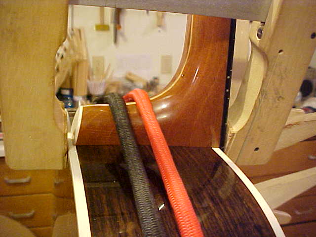

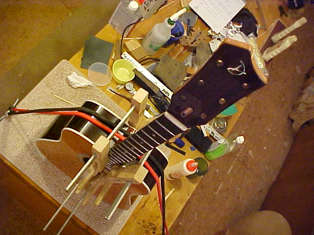

I saw Bruce Petros using some furniture straps when gluing his necks in. So, lacking those, I just tried two bungee cords and they work great. Mario saw this pic and said a properly fit neck joint doesn't need it. But I liked the way it assured alignment while the glue dries. Kind of looks like a missle on the launch pad doesn't it?
