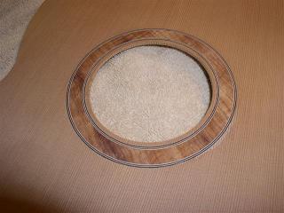

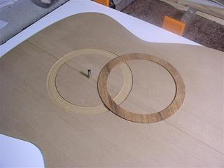

How thick is the burl or other woods you use for rosettes
PostPosted: Fri Apr 01, 2005 9:58 pm
Posts: 8556
mine starts out about .090 or so. Then its installed into the top proud, then sanded flush.

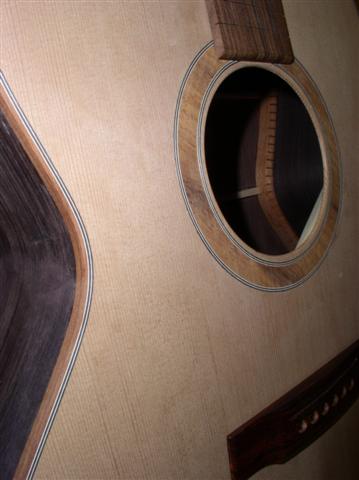

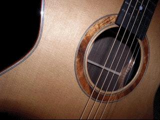

Lance,
Your wood rosettes are so beautiful and clean looking!!!
Do you ever use burl wood?
Maybe burl wood is difficult to cut out?
Thanks for the pic's.
Never get tired of looking.
walter
PostPosted: Sat Apr 02, 2005 2:12 am
Posts: 684
Location: Nashua, NH

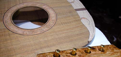

Walter,
I didn't find it any more difficult than any other figured wood. Just take it slow and use sharp bits.
Lance had a demo of this earlyer and I fallowed his lead.
The center of the rosette and head plate in the forground is cherry burl.
Wade
Nashua, NH
http://www.wadefx.com
PostPosted: Sat Apr 02, 2005 2:24 am
Posts: 830
Beautiful!!!!

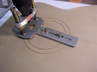

Lance, how deep is your rout
PostPosted: Tue Apr 05, 2005 1:20 am
Posts: 8556
about .050 -- same as a typical shell rosette inlay.
