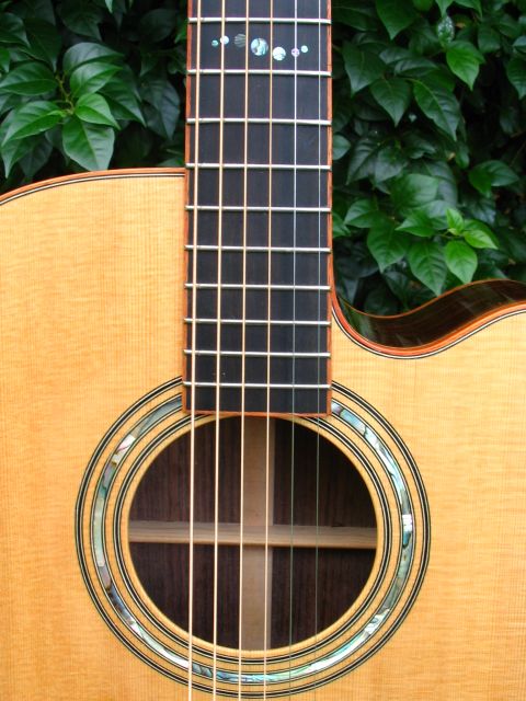

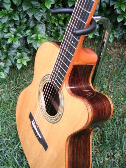

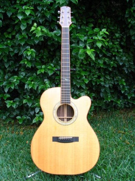

Well I finished my first last night, kinda feeling a bit numb now (is this normal?). At some point last night my woodwork project became a musical instrument. I'm really pleased with how it turned out, far better than I imagined it would when I started. It's not perfect, but then I don't supose many first guitars are. Well, the details:
Built as per Cumpiano, with the addition of a cutaway that was described in Benedetto's book - adapted for a flat top. The top is AA sitka that has started to look a little streaky since it was finished (not that I mind). Back and sides are EIR, the binding is New Guinea Rosewood. Neck is Brazilian Mahogany. It sounds marvelous, but I may be a little biased.

Paul, who you trying to kid? That is an incredible looking guitar. I really like your inlay at the 12th fret and the binding looks great. Can't wait to see your second. Don A38467.0419328704

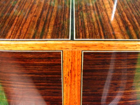

Wow, I can't believe this is your first! It is beautiful! Beautiful Rosette for a first time, and a venetian cutaway too? You must be a glutton for punishment. Great job on the miters too. I don't think mine will look this good after the 10th!

Terry, yes it's a matt finish, ragged on. I don't know how many finishes I tested for the neck before I found one I was happy with. The one I went for is a locally made polyurethane. I simply wrapped a rag around my gloved finger, dipped it in the can and rubbed it on the neck, lost count at about 12 coats and kept going for a few more after that. Just enough to fill the pores, then lightly sanded with P400 grit and then OOOO steelwool. Feels nice and fast. The headstock isn't the worlds most original, but it was one I liked. Here's the pic:

Excelent! Very nicely done! So - it may be your first guitar but WHAT ELSE HAVE YOU BUILT! Your workmenship is fantastic! Nice joints at the butt - rosette looks great! Miters are perfect! Yah like Don said Who you trying to kid! Sandbagger!
