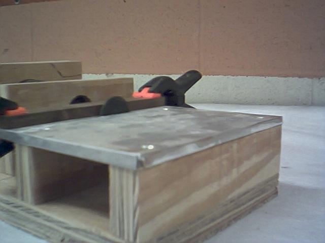

I haven,t cut any of the ablam with this but I use it to cut my abalone or m.o.p. strips. It is quite a bit cheaper to cut them than to buy them pre-cut.
It was made in a hurry but it works quite well for cutting the strips if shell. The smallest I have cut with it are 1mm.
D.L.
D.L.Huskey38468.6780439815

DL,
It looks like you made a little table saw by turning a dremel on its side and using a cut off wheel. Is that correct? Cool idea!
Jeff
PostPosted: Tue Apr 26, 2005 7:40 am
Posts: 244
Jeff,
Yes thats all it is. I can't take credit for the idea though. It is a knock-off of one Amy Hopkins uses.
I think a diamond wheel would give a thinner kerf.
D.L.
