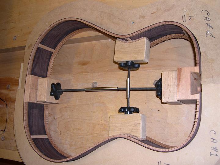

Though I haven't use inside supports when gluing the top and back to the sides, after seeing that some use the supports, I thought I would do it the next time around which should be very shortly. But before that I thought I'd share the design with the OLF. Not wanting a whole redesign of my current support, which was not orginally designed to be disassembled and taken out through the sound hole, I came up with the following. I simply cut the thread rods in half and insert the middle section into a 3/8" - 1/16" thickness brass tube for support.
Here's a picture of the support install before glue-up.

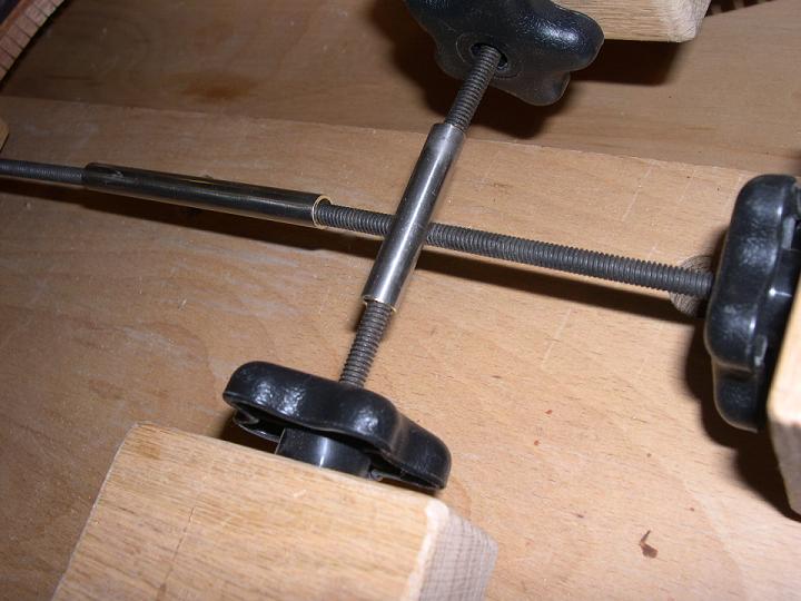

A closer look.

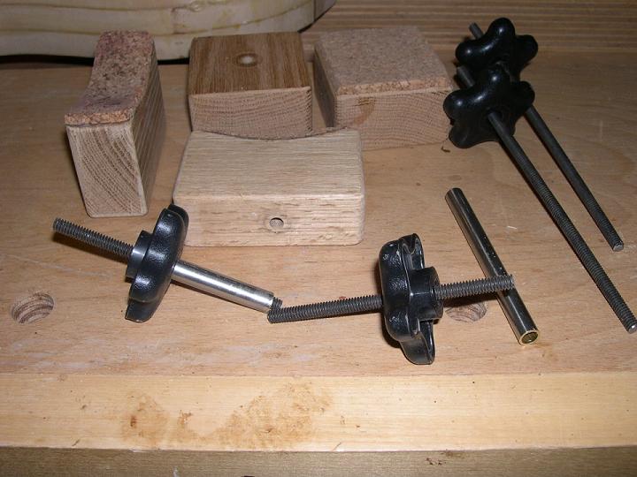

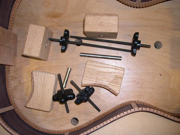

Here are the supports disassembled.
The supports can easily be taken through the sound hole after the back and top have been glue up. One small turn on the pressure knob and the brass sleeve slips to one side and the support falls apart.

I have recently added electrical tape to one half of each thread rod to simplify alignment.

Thanks for the heads up Hesh. I gave it a try and with average size hands I can easily reach the knobs to loosen. I tried it with both a 3" and 3.5 " sound hole. As little as 1/8 of a turn is all that's needed to have the system fall apart.
I was wondering about the supports you used being at the lower and upper bouts and the reason you use this approach. At first glance it appears to be more rigid.
BTW it was your tutorials, which prompted me to post.
Thanks.
Michael Lloyd
