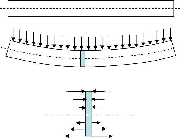

[QUOTE=ToddStock] If you think about an I-beam in bending, the top flange is in compression (it has to get shorter as the beam bends), the bottom flange is in tension (it has to get longer), and most of the material near the center of the beam has been removed because it does not carry any load (does not need to stretch or shrink). The point in the center of the beam where there is neither compression or tension is the neutral axis, and any time we can remove material here, we get very little decrease in load carrying ability, but a big decrease in weight.
Laminating carbon fiber into the center of the beam allows only the fibers furthest from the neutral axis to carry much of a load, so the superior performance of the material under load is not fully utilized. We could remove 80% of the fibers near the neutral axis and see no changes in load-carrying capability.
Using a layer of carbon fiber as a flange (like Rod's approach) allows the extra weight of CF to be more than offset by the improved load carrying performance - the entire piece is in tension or compression, so it is more structurally efficient than the earlier example.
Clear as mud, right?[/QUOTE]

And why do you want conventional braces tall and skinny? Because that puts material as far away from the neutral axis as possible.   That part of the brace that's up at the top is doing the work...another reason not to taper it much.
Also, if you think about the load on the back of a guitar...the neck is applying leverage to the neck block which is attempting to stretch the back and flatten out the doming. That means that the static load on the back puts the back surface in compression and the tops of the braces in tension...a perfect application for graphite topping. Add to that the fact that most players are pressing the guitar back against their bellies, and you add to the compressive load on the surface of the back and the tensile load on the brace tops.
In my back joint reinforcement, I'm using either spruce or cedar in the usual cross grain arrangement, and it is essentially the neutral axis.   It's light weight, decent in compression, and the grain is helping to keep the joint together.   The "flanges" of the I beam effect are the hardwood back and the graphite composite on the top surface.   I suppose I could inlay a back stripe of graphite and make the thing even more radically strong.    Hmmm, maybe I will on the one I'm building now...
I can say that I really like combining wood and graphite in these ways. I think we can have the best of both worlds.   Ken Parker is doing a lot of this in his own way, and to get the strength and stability of graphite with the sound of wood is a worthy goal.

[QUOTE=ToddStock] In the shot below, the unloaded beam is on top and the loaded beam below it. You could think of this as a back brace, where the guitar is resting top-down on a bench and you are applying pressure on the back (engineers - please ignore the simply supported ends, non-uniform section, etc....it's just easier not to explain degree of fixity, I, etc. right now).
Notice the upper surface has to shrink a bit to carry the load, while the lower surface stretches a little...this is what causes tension and compression forces in the upper and lower portions of the brace. I cut out a small element of the uniformly loaded, rectangular brace, and you can see how both tensile and compressive forces decrease as you move toward the neutral axis, as Rick indicated in his note. The arrows indicate the amount and direction of force being applied to the beam element...I eliminated reaction forces in the upper drawings to simplify things.
Todd,
How strong are these forces given that most people profile the braces to the surface shape of the back rather than fit flat braces and curve the back to tension the braces as your diagram sort of suggests? I would have thought that the main forces on the back will come form string tension on the neck pulling at right angles to ladder braces (subtley different for X braced backs) trying to flatten the long arch, and the pressure of the air pumping in the top which should go in cycles in two directions.
I'd love to see a scientific measurement of "beer belly" force on the back I can see how it would dampen the backs vibration but how much pressure does it exert. Mind you if you did Rick's equivalent of standing on it via a "beer belly slam dunk" the that would be an altogether different matter
