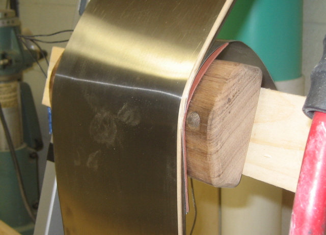

Sample Walnut, .102 thick
Wrap in kraft paper
Bender is heated to 280-300 degress AND then the wood is loaded into the bender. I only want to heat the wood when I am bending to not dry it out.
At this point I support the upper arm of the bender, hook the lower slat with the upper slat and apply 40 psi to the air cylinders to pull the slats in tension.
I bend the upper arm back which creates about 75% of the waist bend.
Keep in mind that I have a 5 x 6 heating blanket at the waist caul to just heat the waist.
Bending the lower bout.
I now tighten two clamp knobs that brings the waist in tight with the form.
Bird's eye view. Ready to bend the upper bout.
Bend the upper bout.
Let the wood cook for a few minutes (still working on how long)
I release the pressure on the air cylinders and un-hook the lower slat from the the upper slat.
I return the bender arms to the original upright position. This leaves the bent wood on the mold which can easily be removed and the process started over for the next side.

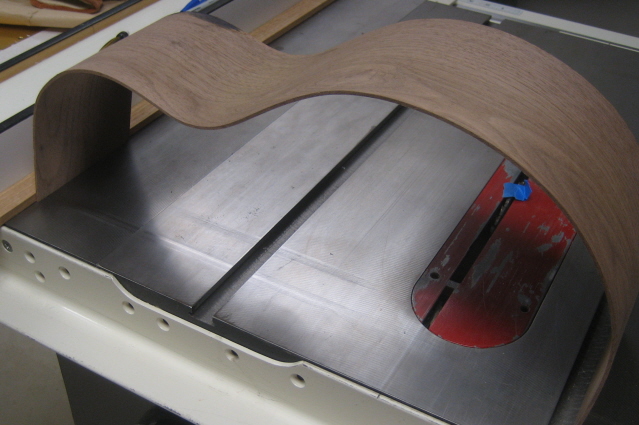

Ahhh....a newly bend side. (I have the side clamped between my table saw fence so it looks like there is no spring back but there is some)
Since the sides are bent dry they don't cup, distort, or discolor.
I am still working out the details but so far I have bent about 10 sides for testing and the results are very good. I even bent a curly maple side at about .120 thick just to push it and it had two small cracks in the waist.
