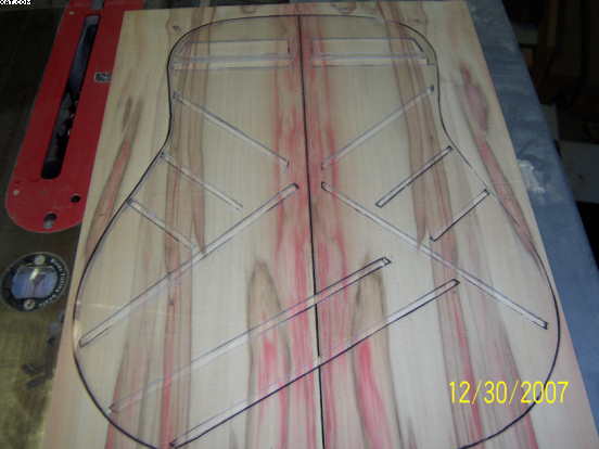

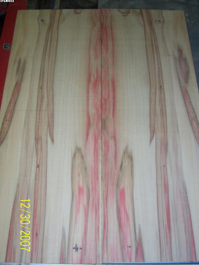

Here is what I am working with. I really dont know how this will work for making invisible worm holes, but I just have to use this wood. As far as I know nobody has built a guitar with box elder??
I bought this wood and paid a fortune for it. I didnt notice the worm holes when I got it because the wood was rough sawn and the holes are very small. Now that I have resawed it, they show up. I had planned on selling some of this wood in order to recover some of my costs, but I dont feel right about selling wood with worm holes in it.
I think you can see the holes in the third picture.
PostPosted: Sun Dec 30, 2007 10:22 am
by the way, my lexan template is laying upside down, so dont pay attention to the tone bars going the wrong way.
