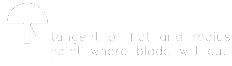

You know!? I got a bit chastised a while back when I tried to explain that even the Stewmac tang nippers left a small amount of the radius formed in the extruding process and that filing was still needed. I started to do a scetch to show why this happens but got buszy at work and forgot to. Thanks Hesh for pointing this out again.
With any tool that you use to cut the tang, the radius formed in the extruding process will cause the cutting blades to slide down to the tangent point of the tang flat and said radius. Now this is a very small radius so some may find it insignificant and may hammer or press the into the bindings. But I like to file it off. It only takes a swipe or two and it is gone.

Thanks Michael. You know, I've always just taken the final cleaning up with a file as a given, and just wrote it off as a bit of slop in the nippers. Since it always seems to leave such a consistent bit of tang, regardless of how careful I am or which set of nippers I'm using, that explanation makes perfect sense. I just never gave it much thought. Thanks again.
