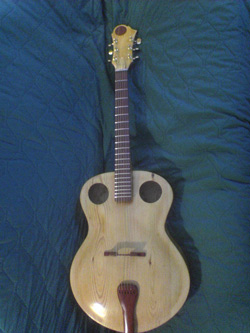

Hi, I am new to this forum. I have successfully built my first archtop following the Benedetto "bible" to the tee. My Home Depot guitar was constructed with plain maple sides and construction grade fir (2x10). Its the cheaper pile of firewood theory. I used Bloodwood for the fretboard and the other fittings rather than Rosewood or Ebony because I simply had it available from a different project. It sounds great.....until I unstrung it and started dressing the frets. I have managed to bork my first fret leveling. There simply isn't enough material to recrown. These are medium frets. I don't have the dimensional specs for the fretwire. Is there a clean way to remove the frets without any fretboard chipout from the fret tangs? I tried this on a previously crafted ebony fretboard, when I finished removing the frets, the fretboard looked like swiss cheese. There were more deep chipouts than I could contend with. I have resolved myself to doing a full refret. I will try to post a few pics as soon as I can pry them from my PDA.

Ok, I got the pics off of my PDA. What does the heat do when removing the frets? Doesn't heat cause matter to expand and not contract? The frets were just hammered in, not glued. Also I looked over Tim's fret how-to. Wonderful document. I will follow it when I refret.
Made from Home Depot construction stock.

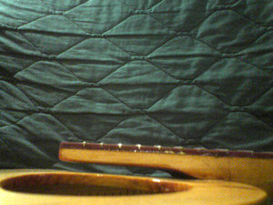

In Tim's example, the fretboard extension is glued to the top where support can be placed beneath while hammering. How do I support this while hammering?

View from the neck extention.

"In Tim's example, the fretboard extension is glued to the top where support can be placed beneath while hammering. How do I support this while hammering? "
Good question? Wellllll, you need to find a tool that has enough mass yet will slide under the FB extension and allow you to hold upward pressure in that area while gently, and ever so gently, tapping frets in, in that area of the FB. I have an autobody tool that is called a "spoon", that would work quite nicely. Go to a local body shop and asked the people there if they have a body "spoon" that you could borrow or rent for a couple of hours. Take your guitar and try it on for size. Heck, you might even get a comissioned order from them
