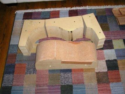

Having taken in all that has been discussed/learned so far, I think that if you can get through the bending you will be OK. What I had trouble with were the two different grains that they mention on that site (probably why they say it does not steam bend very well). If you have an orphan side I would like to try and bend one on a bender that I have used for woods like Lacewood (and other hard to bend woods) with superb results. It is more of a press than anything. I use a heating blanket, foil, white paper towels, distilled water (very little) and two clamps. It is not very pretty and although I did make some minor (but effective) changes to the design it is not my design either but it works great and I am wondering if it would work on the GA. Here's a picture...
