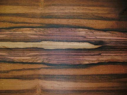

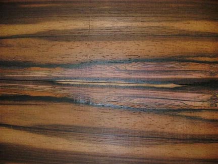

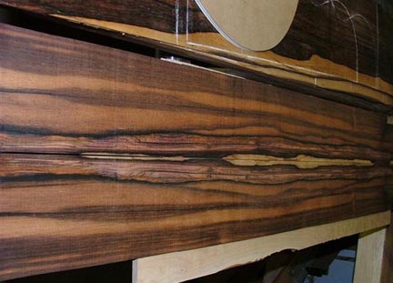

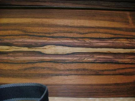

My new Lenox carbide TriMaster blade managed to cut through a 8.5" thick piece of really dense ziricote , and some brazilian rosewood today. Here's a few pics of the Brazilian sides...
Ugly wood, but if someone has to be stuck with it, it may as well be me!

At best, I'll have two backs out of this board, and I managed only one more set of sides. Then I ran into some large fractures. I might only get a set for a OO or something smaller from the other half of the board for a back. But there are several other planks waiting to get some slices. But if the other half of the board won't yield full backs, it will at least yield sides. Or 3-piece backs perhaps.

Gary, I didn't show any pics of the ziricote! Those were all Brazilian. I can take a pic of the ziricote though if y'all want a pic. Not much to say there, just straight grained ziricote, nothing fancy, 8.5" wide or so, and very dense. The most dense ziricote I've come across. The cut wasn't as smooth as I would have liked, but it got through it, and that's the important thing. It has a very glass-like tap to it. Not the most stunning looking, but tonally it could be the best I've ever had. There's roughly 3 sets there, and I'm selling at least one of them at some point.

If you'll look at the top picture, you'll see sanding marks on the bottom piece. The top piece is right off the saw. Sometimes I get a clean enough cut to go right back to the saw, but most times I run the board back through the sander lightly to take out any minor irregularities, which will only be amplified in the next cut if they are left in. Just like Bruce thought.
