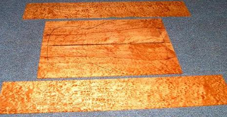

Speaking of special Mahogany,
This is what I may be using.
Brian Hawkins Beach Tonewood Just cut up a bunch of this stuff.
Ill be auctioning off this very set next week.
