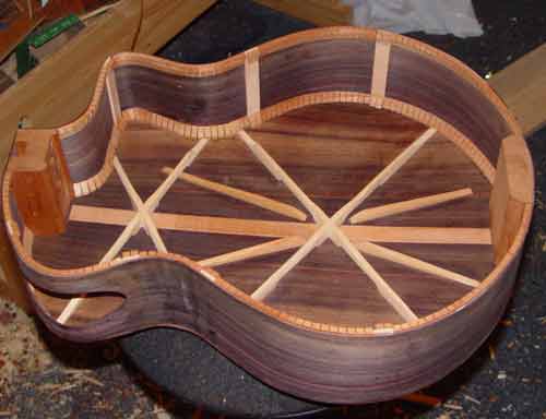

My back bracing is a bit different, but I use about 7.5mm wide and 16mm high for the x-braces. This one still needs a good cleanup!
