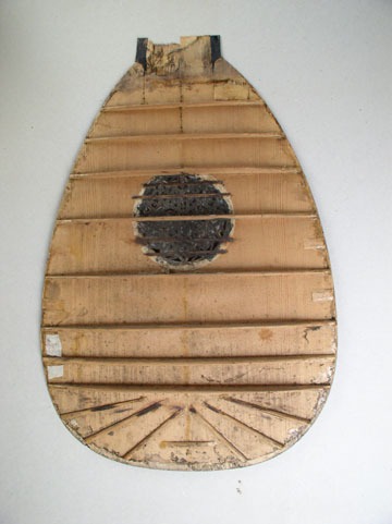

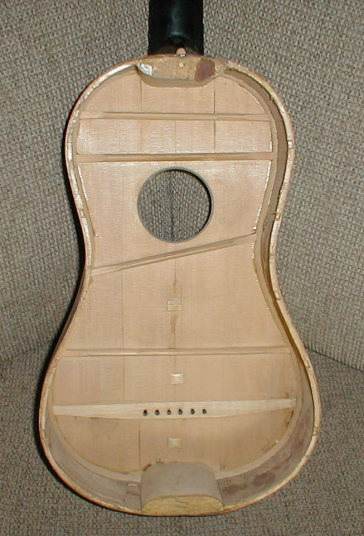

You might find these pictures interesting. They reflect the development of bracing to match the tension on the top.
This shows the top bracing on a 1780 six string guitar, it has just moved on from the plain ladder by including the asymetrical brace below the soundhole to stiffen the treble side.
This is from a 1764 13 course lute by Brunner, and shows the early evolvement of fan bracing.
My lutes use similar but less ladder struts and fan braces.

That 1780 guitar is very minimal in its bracing, do you know what the top thickness is, roughly? Beautiful shape, that guitar... there is a certain elegance to the shapes of that time which seem lost now. The replicas of such peroid instruments I've seen an played were surprising in their volume.
Francisco Sanguino sometimes had no bracing in the lower bouts of his vihuelas, but I have no information as to their top thicknesses. He did use fan struts, however, on an instrument of 1759, and this is their first known use to my knowledge.
The fan struts on the lute are very interesting... one almost wonders if something odd was happening with the spruce down there..
The more pictures of old guitars, such as above, with cracks in the upper bout by the fingerboard, really get me thinking about what a good idea reinforcing this area is. The size of the heel is also something interesting to think about. Torres also used fairly small heels at times, though not this small. I haven't seen anybody claiming this to have caused any problems (things like this are important to observe, as nowadays we seem to try to make everything as rigid as possible..., which may or may not be a good thing).
I'd love to see the front of that lute top, if possible Colin, and the rose. Are you using fan struts somewhere on your lutes Colin, or just ladder braces? Don't forget to show us pictures of your latest, either... a little birdie told me you strung up a new one recently.
