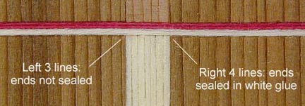

PostPosted: Wed Mar 02, 2005 4:04 am
Posts: 183
I did a test regarding this the other day. With respect to purling lines, not bindings, but I assume the same would be true for bindings. In the photo below, the ends of rightmost four lines were dipped in LMI white glue, left to sit a couple of minutes, and pulled through a paper towel to remove the tiny drop of LMI white glue on the very end. The lines were inserted dry and flooded with CA.
I cut the white lines from Aspen, which as you can see, don't seem to soak up any color from the CA even without sealing the ends. So this doesn't actually prove that sealing with glue works ... I should have used Maple. I've seen maple lines that almost disappear when flooded with CA. Anyway, I read of this method, and I figure it should work with bindings too. I'm pretty sure it's in the Fox style dry assembly GAL article a few issues back.
