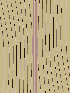

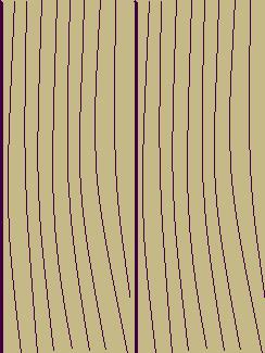

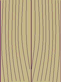

Which of the following is the proper grain orientation for say a neck lamination or heel block?TIA

PostPosted: Sat Mar 05, 2005 10:55 am
Top or middle, either one, for a neck lay up. Heel block, dunno, never done one of those?

Your best bet is to arrange the laminations with the outer edge of the tree along the center, like this:
I think that's the first image you posted.
PostPosted: Sat Mar 05, 2005 11:38 am
I do believe Bob is right...

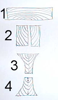

The reason I said either.... you can't control it in a neck. Why, you ask? I use sixquarter material and cut it from a slab eight inches wide. Each layup makes two necks, so if there is a curve, it usually comes together at the heel of one blank, but less so on the opposite blank.
Hard to visualize, but I'll try:
1. A plank of flatsawn mahogany approx 1 1/2 " by 8 "
2. The plank cut in two pieces with best match of grain.
3. Top neck of the blank
4. Bottom neck of the blank grain is reversed.
Fairly simple. I usually like one end better than the other each time I do a glue up. But the main thing is that they equally conteract the grain of the opposite piece to which their glued. Plus, mahogany is just pretty stable wood regardless of how it's cut or glued. Gibson loved to take three one inch slabs, glue 'em up and make a neck.

I suggested using pieces arranged so that the outside of the tree in the center for stability reasons; they are least likely to delaminate in that arrangement (think about the way a board will cup as humidity changes and the pressure on the glue line). I think Al Carruth suggested this and it makes sense to me.
Bruce, I agree that in most cases it will not matter much; and given the way in which you make your laminations, you may not have much choice.
