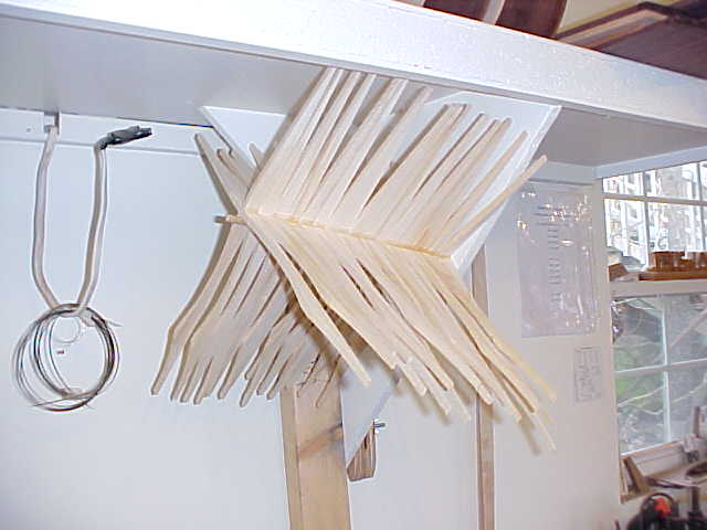

Scalloped Adirondack Braces to love. Just wanted to share a picture of 17 of 20 made last week. Have a great day, It's Spring down here!
Chaos:
Organized:
25' Radius, perfect quarter, stress tested, super-glued joint, and gets a top cap at glue-up and tapering sides toward the peaks. Dickey38418.4200462963

Lovely! Only a bunch of geeky Luthiers would lust over a pile of STICKS!
PostPosted: Mon Mar 07, 2005 6:30 am
Posts: 908
Love the storage system!
PostPosted: Mon Mar 07, 2005 6:57 am
Yup. A 5/16th " dowel rod glued in the upright.

Here's a potentially dumb question for you guys. Is it common practice to use CA to glue the x-brace? I've just been using Titebond.
I do glue on a cap piece on top of the joint.
PostPosted: Mon Mar 07, 2005 8:34 am
I use thin CA. The reason, I align the braces first, and it just makes sense to wick CA into the joint. Then of course I Titebond on the cap and Titebond it to the top, others use hide glue there.
I just want my braces to slip together flush, then without moving them, CA is wicked in.... from all four sides wiping each of four intersections before moving on. There just doesn't seem to be room for glue otherwise it's a tight fit.
Matter of fact, my braces are .315 which is 5/16" thick. I found that the notch cut with a 5/16 inch single edge carbide router bit, needed adjustment to about .308" to slide together without forcing, but was not loose at all. Could be that the router bit is just cutting it .006" too small, or that the fiber in the cut takes up room?

Mattia and others. If you've notched xbraces and not paid attention when putting them together, they can go together wrong. Murphy's law comes into play at that point.
A few sessions back, 'bout a year ago, I slapped these xbraces together CA'ing all the way. Then on the last one, I walked across the shop to my plexiglas template and held up the x, YIKES! It was wrong, matter of fact all seven I'd just glued were also wrong. Five out of seven sets broke trying to get them apart..... grin.
Moral of the story: "Know your angle, before you glue." The only purpose for the CA is to hold it steady for final radiusing in the sanding dish, 25' for me.
I learned a little trick that works to get the angle right. Hold both notches up and to the left, short end up. Bring the left brace over the right brace and slide together. I can't explain why, but it works every time. No more wrong angle braces.
You'd think it would only go together one way but it will go together two ways: right and wrong....
