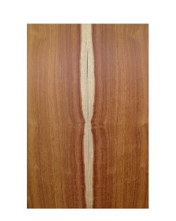

Oh here's what it looks like at 90K. Hope it posts...
PostPosted: Wed Mar 16, 2005 1:50 pm
Posts: 1584
Location: PA, United States
Grenadillo before I joined the back.
PostPosted: Wed Mar 16, 2005 2:02 pm
Posts: 1584
Palo Escrito back before joining
PostPosted: Wed Mar 16, 2005 2:15 pm
Posts: 1584
Wacky Palo Escrito before joining back
