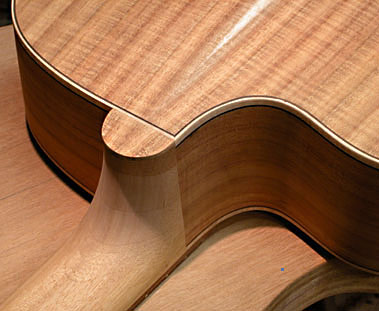

Harald,
You could bend in the odd angle with a pipe after you have completed the other bends with the Fox bender. Since you have to make a block that conforms to the angle anyway, you could use the block to hold the angle as it cools and dries after you ballpark it on the pipe.
I do hope this is what you guys are talking about?
Wade
Nashua, NH
http://www.wadefx.com
PostPosted: Fri Mar 18, 2005 7:03 am
Whoa-ho! Wade, ya been holdin' out on us Mamma-miya what a beauty!
PostPosted: Fri Mar 18, 2005 7:54 am
I always touch mine up on a pipe. I tried to come up with a way to make the bender do it but alas I couldn't. Charles touches his up on a pipe as well so my guess is that there is no way to do it on the bender or he would have found it.

Thanks all for your replies. It seems that I have no other choice for bending on the hotpipe. After a discussion with some violin makers, one came up with the idea to bend an normal Cutaway and then change the radius on the hotpipe. Thats the way he does when building a Viola da Gamba.
Wade: Great looking work!
Again thanks all. Harald
