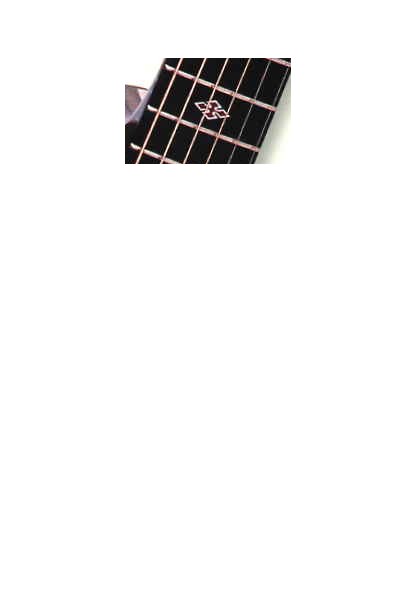

This is a cropped picture from Bill Wise's Charis Guitars brochure. I like the inlay. I have an idea or two how it's done.
Anybody doing these types of inlays? Care to share your techniques? Please post pictures!

Draw out the pattern, pierce the inside of the material your making the border out of with a small drill bit, cut out the inside, fill with an ebony (or other material) cut out piece to match the pattern from your original drawing, then glue it into the pierced piece.
Then go and cut out the border as thin as you want to. File to thickness. Inlay the rest normally.
