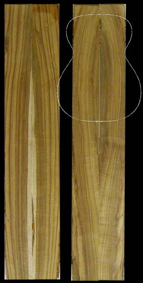

Hi Folks,
I recently received a gift from Hawaii - some nice Koa planks. But the Koa is too small for a two-piece back. A simple three-piece wedge design may work, but because the Koa is dramatically figured with bold stripes, I'm thinking it could end up looking horrible with all the mish-mash of curl and bold figure at all different angles.
I'd like to formulate a "resaw plan" before I cut it up in order to maximize my output.
Do any of you have any creative ideas to how to arrange a multi-piece back that would use the beauty of the Koa in a manner that wouldn't clash or otherwise detract from its natural beauty? A second type wood in addition to the koa? A non-wedge multi-piece? .... ??
Pete
(The second photo shows an end with a little shellac thrown on it).Pete Licis38429.6157175926

Pete,
How about you make a joined center wedge using the sapwood then surround it with matching side pieces.
Or,
The part you have marked looks good. Try flipping the left over up to join the sides. Sometimes if you use the same plank you can find a close seamless match. Either way you have a 4 piece back but the figure will be symmetrical.
Wade
Nashua, NH
http://www.wadefx.com
PostPosted: Fri Mar 18, 2005 7:21 am
Pete, here is a quice down and dirty pic of a 4 piece back. I just took the boards from below your drawing and flipped them up to make wings. I think it looks ok. Paul

Posts: 183
Hmmmmm ... not bad, Paul!
Wade, I love sapwood and intend to keep as much as possible of it, but unfortunately, it's largely unsound on that board.
Good information for me to think. Keep 'em coming!
Pete

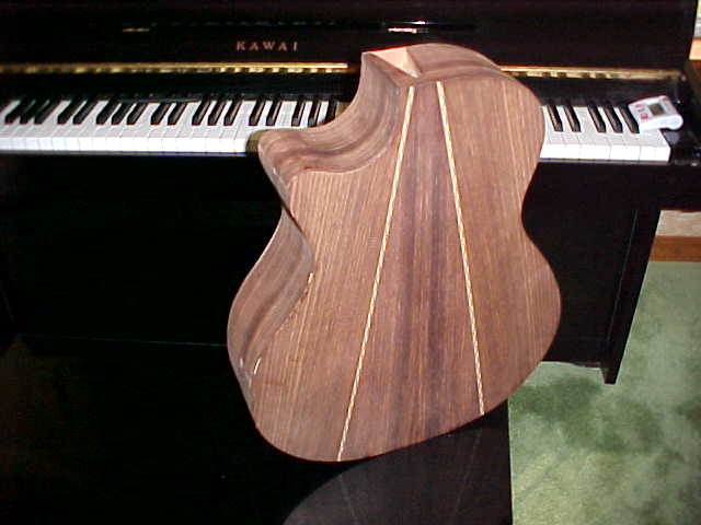

PostPosted: Fri Mar 18, 2005 10:19 am
Posts: 1584
Location: PA, United States

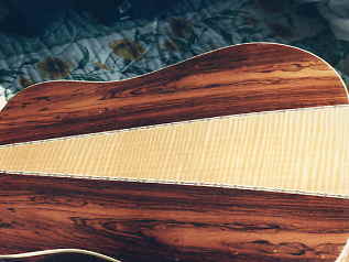

I repaired a guitar once that had a nice 3 pc back, the middle wedge was tiger striped maple. I think the wings were (laminated) brazilian RW. I'll scrouge it up and post it if I can.

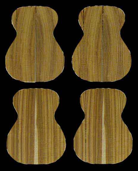

THANKS FOR ALL THE THOUGHTS, FOLKS! Gotta love this place!
I played around in photoshop some more, and came up with a few ideas. In the photo below, I show one back "made" from each plank. Within each pair of photos, one is bookmatched center, with flitch matched wings, the other is a bookmatched center with "reverse bookmatched" wings. Whadda ya' think?
To me, the results don't look bad (especially at the low resolution of the photo), I just hope I can pull it off with the resolution of 20/20 vision. (Which I haven't had for ages!)
Thanks!
PostPosted: Mon Mar 21, 2005 2:23 am
Personally, I'd pick the one on the bottom left. That's a nice look.
PostPosted: Mon Mar 21, 2005 3:12 am
Personally I would use a wedge of contrasting wood Like a maple. If not I would say the lower left or upper left. I love the look of sap wood but I think I like the upper left the best
