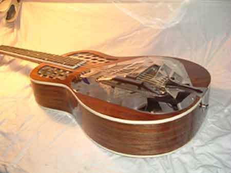

I have built a few over the years, a friend and I built a metal Dobro in 1989 he done the metal and I made the neck and put it together. I built a wooden single cone national ,after much difficulty I made the metal cover plate. The latest is a all Walnunt "tricone" it has a maple neck that runs through the body.

I agree with John about the body being rigid ,I also think the bar going through the body helps the volume .
The sound well on my single cones are made of very thin steel ,with the cone sitting in this . the sound well is fixed to the bar running through body again adding rigidiy.
The sound well on the Tricone is a bit of a compromise;
the well is made of laminated maple with the bottom being brass. The Tricone was a lot more work than the single cones,the sound with the walnut is a lot warmer and being 3 cones there seems to be more sustain.
