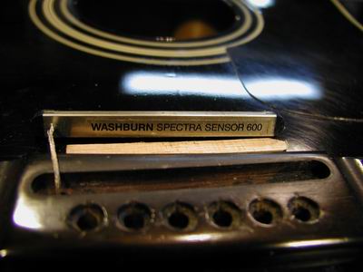

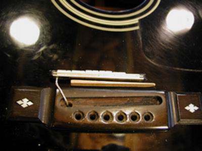

Both suggestions are excellent. I might get the slot jig for the future. One can never have too many toys, I mean tools. I am not sure if it applies to my situation. I may not have explained what I have correctly and fully.
The guitar had a plastic shim under the saddle/pup when it came in. It was just a small piece of plastic under the low E string and the rest of the saddle/pup was floating free. I made a mahogony shim to correct the action issue but the G string is still silent.
As you can see, it is a seal saddle/pup configuration. I tried contacting Washburn and have no response yet.
Any additional ideas are welcome.

Hi Bob,
     In my shop, if the customer for some reason was in love with this
instrument, I'd cut to the chase and advise him to plug the current
saddle slot and cut for a new 3/32 bone saddle and standard
aftermarket under saddle transducer. My suspician is that you'll end
up making the strings intonate much better and the new pickup will
likely be better quality too. Of course He's got to be willing to spend
$200+. I think trying to make that pickup balance will not be worth
your time, and it will still be mediocre in the end.
