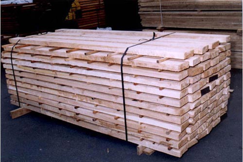

PostPosted: Wed Jul 19, 2006 5:55 pm
Here's a pic I found on the net. They've strapped it rather than weighted, but you get the idea.
